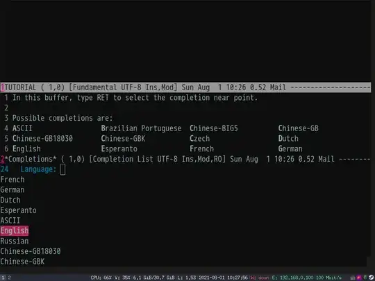

It's M-x help-with-tutorial (M is the Alt key).
But I suggest using M-x help-with-tutorial-spec-language,
C-h t

one time. – lawlist Jul 31 '21 at 20:48M-x tutorial
or something fundamental. – eguneys Jul 31 '21 at 21:17help-with-tutorial
