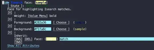

First, I have removed (setq-default frame-background-mode 'dark) from my .init file. The reason, I wanted to use (setq-default frame-background-mode 'dark) was to make highlights clear to read. Due to dracula-theme it was so lights and during word seach font color gets white.
In order to achieve this, I have update settings for Isearch and Lazy Highlight using M-x customize-face.
Following lines are added into my customize.el file:
(custom-set-faces
 '(isearch ((t :background "#f1fa8c" :foreground "#282a36" :weight bold)))
 '(lazy-highlight ((t :background "#8be9fd" :foreground "#282a36" :weight bold)))))
