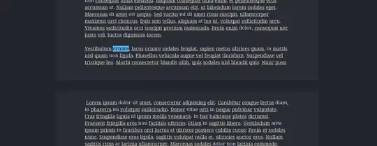

I want to insert an overlay at the beginning of every 40th or so visual/screen, to generate a WYSIWYG looking page-break overlay like so: enter image description here
At the moment this is done by font-locking the line-feed character (with overlays), which works but it edits the text and makes the overlay too concrete. Ideally I would have a minor-mode running which inserts overlays at the start of every nth visual line to prevent this.
While I found how to move x number of screen lines or get x number of screen lines in a certain region, https://www.gnu.org/software/emacs/manual/html_node/elisp/Screen-Lines.html, I have not been able to figure out how get that position so that I can use it in the declaration of the overlay. Maybe this is doable with some complicated compute-motion, but I am not exactly sure how that would work.
Any ideas?
This is a partial copy of Obtain points at beginning/ending of visual line without using vertical-motion, but that question specifically concerns obtaining the beginning/end of the current line, not any line. While I could iterate over the entire file and obtain those coordinates, that is obviously not very feasible.

I've figured it out! You can use save-excursion to get the position of the n-th visual line
(defun get-visual-line-start (n)
  "Get the character position of the 'nth' visual line, serving as the visual line number."
  (save-excursion
    (goto-line 1)
    (vertical-motion n)
   ; (end-of-visual-line) ; for the end of the line instead
    (point)))
Then do something like
(let ((n 40))
  (dotimes (line (round (/ (count-screen-lines) n))
    (let* ((line-pos get-visual-line-start (* n (1+ line)))
          (ov (make-overlay line-pos line-pos)))
    ;;; do something with the overlay
Tada
