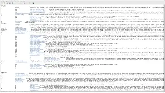

emacs-buttons provides buttons-display, which with a prefix argument displaysa recursive visualization of all current bindings.
(Disclaimer: I am the author of the package)
https://github.com/erjoalgo/emacs-buttons/blob/master/doc/img/sample-visualization.png
