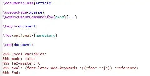

  2. In your .tex file, add an entry to the file local variables which can look like this:
    \documentclass{article}
    \usepackage{xparse}
    \NewDocumentCommand\foo{d<>m}{...}
    \begin{document}
    \foo<optional>{mandatory}
    \end{document}
    %%% Local Variables:
    %%% mode: latex
    %%% TeX-master: t
    %%% eval: (font-latex-add-keywords '(("foo" "<{")) 'reference)
    %%% End:
    It looks like this for me:
