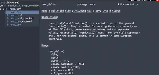

When I input a function, the R help document pops up automatically. It's very annoying. How to turn it off? screenshot

This is an interaction of company-mode with ESS. You can fix this issue like this:
(setq ess-use-company 'script-only)
This disables use of company-mode in the R terminal, but makes it available in R scripts. To disable it entirely in ESS, just use
(setq ess-use-company nil)
More useful information about company-mode with ESS can be found here:
https://www.emacswiki.org/emacs/ESS-company
