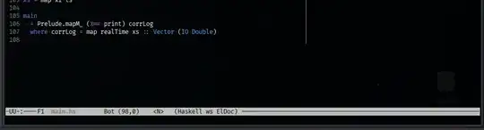

Obviously Emacs never scrolls "above" the first line of the buffer. By contrast, it shows a bunch of empty space after the document if you scroll to the last line:
End-of-buffer whitespace
I want to make the bottom line behave the same way; essentially similar to this question:

Edit: It seems I was not clear enough in my original question. Here is a short video demonstration of the behavior I mean. Notice how when getting within the scroll margin at the top of the document, Emacs prevents movement above the document, but at the bottom it just pads the document with empty space.
