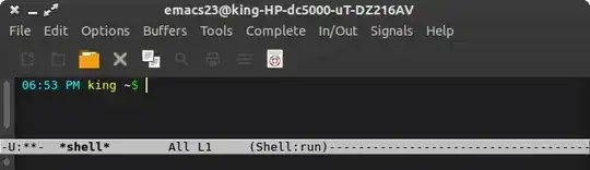

Of course when I am in Terminal and I press the up arrow key, it goes to the previous command. However, when I hit the M-x keys and type shell an integrated shell comes up in Emacs:
Shell in Emacs

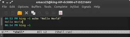

However, if I type a command and press up, this happens:
When I press the up button in Shell Emacs
How do I get back to the last command I typed?

The function that cycles backwards through input history, saving input. is comint-previous-input
It is bound to C-up, M-p.

Just found an answer on Super User:
How do you run the previous command in emacs shell?
M-p goes to the previous command.

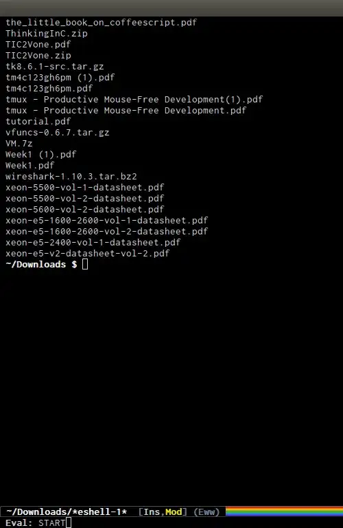

You could use helm-eshell-history for interactive history selection, and replace the original C-c C-l:
(require 'helm-eshell)
(add-hook 'eshell-mode-hook
          #'(lambda ()
              (define-key eshell-mode-map (kbd "M-l")  'helm-eshell-history)))
;; for shell-mode
(define-key shell-mode-map (kbd "C-c C-l") 'helm-comint-input-ring)
helm-eshell-history

Things have changed in Eshell a little.
The module em-hist.el is implemented based on the minor mode eshell-hist-mode since commit 1ee0192b79 in the Emacs git-repro. Currently, this commit is only in the master branch of Emacs (i.e., 28.0 as of today). It has been reverted in the Emacs 27.1 by the commit 478638e470 because of Bug#41370.
So here is my updated working solution for using helm-eshell-history
   (use-package eshell
     :config
     (require 'em-hist)
     (use-package eshell-git-prompt
       :config
       ;; the powerline prompt is best but I've no idea how to shorten it to the last directory.
       (eshell-git-prompt-use-theme 'powerline)
       (define-advice eshell-git-prompt-powerline-dir (:override () short)
         "Show only last directory."
         (file-name-nondirectory (directory-file-name default-directory))))
     :bind (:map eshell-hist-mode-map
                 ;; ("<down>" . 'next-line)
                 ;; ("<up>" . 'previous-line)
                 ;; ([remap eshell-previous-matching-input-from-input] . helm-eshell-history)
                 ([remap eshell-list-history] . helm-eshell-history)
