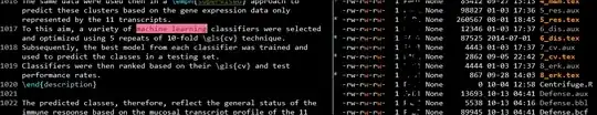

I am about to adopt Emacs to be the only editor I use in all what I am writing including LaTeX documents. I came from WYSIWYG editor which served that purpose fairly nice, namely TexStudio or TXS for short. For the transition from TXS to Emacs I am still missing the way TXS deals with executing massive regexp query search & replace with highlighting the matches and restriction of the search to only those project-related .tex files. I deeply miss that in Emacs now. See a screenshot of TXS below:

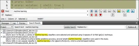

TeXStudio Query in a Multifile LaTeX Project enter image description here
I would like to emphasize the points in the workflow to be achieved in Emacs:
  1. RegExp Query Search and Replacement only in the project-related .tex files.
  2. Highlighting the matches
  3. An overview of the highlighted results all together in a manageable layout (similar to the log view of Magit in Emacs when you press l followed by another l or simply like C-x d in Dired mode
  4. How to know how much replacement or inspection matches done with or remaining and a way to resume query in case it is broken by a clumsy keystroke that stops the query
  5. A clean way out of this messy query by closing and saving all related files and back to the state before invoking this query
I read this post but my intention is to be more like CW that anyone can share his best workflow to get this common job done. My current approach(es) as follows:
First Workflow

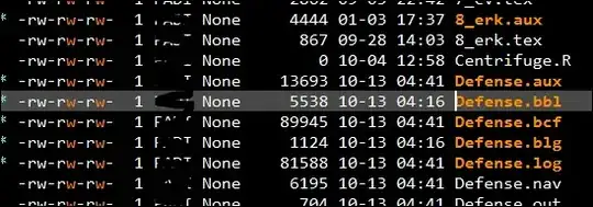

  1. Dired mode % g will mark all files containing that regexp. Cons: this will include even file unrelated to the project including non .tex files.
  2. C-x 3 opens a new buffer while keeping an eye on the first buffer as my orientation overview of what marked files I have to query in the new buffer individually
  3. Running the query by C-c q. It has very nice switches like ! replace all without asking plus highlighting matches within the opened file. But this means I have to run the same query each time and for every marked file.
  4. After doing all marked files I hit C-x s ! to save all in one keystroke. Phew!
Second Workflow -- preferred
  • Marking all .tex files using % m within Dired-mode by regexp in order to mark only .tex files so basically running \.tex will get me there.
  • C-x 3 same as above to keep one buffer for overview and the other for query
  • Executing Q within Dired which is query replace regexp in marked files only. Alternatively A is only regexp search query. A full-fledged query will be executed and a help menu by ? is generously provided
  • C-x s ! save and close all the mess. Otherwise I had to close the opened files one by one which is tedious. I hope there is a way to close only those we bothered.

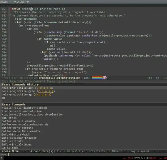

If I understood correctly, you want to search for text patterns in your project, then you may want to use Projectile along with Helm.
  • M-x helm-projectile-grep
  • Type text pattern or regex pattern.
  • See updated results for every character entered.
Here is a demo of helm-projectile-grep:
You can save into a separate buffer to refer later using Save results in grep buffer action` (you switch to action buffer using TAB, by default).
If you haven't heard of Helm, you can read my Helm tutorial. Visit my Helm Projectile tutorial for more demos and guidance on Helm Projectile.

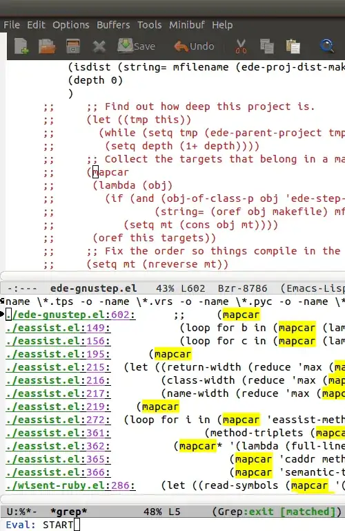

Alternative, you can also use rgrep, which is built-in:
  • M-x rgrep
  • Enter text/regex pattern into Search for: prompt, i.e. "test"
  • Enter file type to search for into Search for "test" in file:, i.e. *.tex.
  • Enter directory to recursively search (hence the name rgrep).
  • Press RET and see results.
A rgrep demo:

You "resume" by running the query again if you accidentally stop it. But using Helm, you have a helm-resume command that resume you back to previous on going operation if you accidentally cancel it.
  1. A clean way out of this messy query by closing and saving all related files and back to the state before invoking this query
Actually, you don't have to kill any buffer if you use tools like helm-mini. Managing thousands of open buffers is a breeze: you can narrow to your desire buffers with a short text pattern. You can kill all at once if you want.
Here is a demo of helm-mini:
helm-mini
See the detail explanation in Helm Github page, in "Advanced Usage" section.

  • what keystrokes do you use in rgrep to visit the match occurrences (forward or backward) in the upper and lower buffer? – doctorate Jan 03 '15 at 20:06
  • I used M-g n and M-g p when cursor is not in the *Grep* buffer. In *Grep* buffer, I simply use n and p. See Compilation Mode. You should have a look at Helm and Helm Projectile when you are free. It's definitely worth your time. – Tu Do Jan 03 '15 at 20:09
