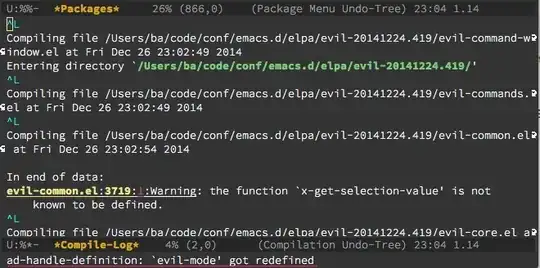

I just installed evil-mode from melpa and when the installation finishes I get the message ad-handle-definition: 'evil-mode' got redefined.
I can then enable evil-mode but get the same warning. But the next time I open emacs and try to enable evil-mode I get this error: Autoloading failed to define function evil-mode
Searching around leads me to understand basically that somewhere along the line evil-mode gets redefined or lost, but I don't know where to start in debugging this.

  • ad-handle-definition: 'evil-mode' got redefined isn't an error. This happens when some advice for evil-mode has been evaluated in advance of evil-mode itself being defined or loaded. When the function is defined, the existing advice immediately redefines it, and Emacs provides notice that this has happened. If the advice is instead evaluated afterwards, this notice will not occur. – phils Apr 14 '16 at 05:15
To disable the initial warnings, I use:
(set 'ad-redefinition-action 'accept)
I haven't encountered your other errors, but they might be offshoots of the above. I haven't either investigated the side-effects of setting the above variable globally, I'll update this answer if I find any issues.
