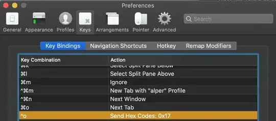

Please note that this works. I want to have same setup on my Terminal shell. By default \C-w does it (link).
So I created following key binding (\C-o) in iTerm2 in order to delete a word by following this solution, which works on Terminal shell.
Delete a word - Send escape sequence - 0x1b 0x08 or 0x17
But when I enable it, my key binding for C-o in Emacs starts to not work. iTerm's keybinding suppresses Emacs's, even though they do the same job.
[Q] How can I use link Emacs and iTerm for the same key binding? I think I have to do a incode-decode-map (https://stackoverflow.com/q/36613839/2402577) but I wasn't able to do it.

tl;dr
@drew is right, you have a conflict. Use C-backspace in Emacs to delete the word to the left of the point. At your shell command like use C-w to do the same.
Long answer
@Drew is correct, you have a conflict between iTerm and Emacs. Unfortunately there's not much you can do about that, so let's focus on what you want to do, "delete word".
As you've discovered, Emacs has a "delete word" function, backward-kill-word. This will delete the word1 to the left of the point. By default backward-kill-word is bound to C-backspace.
Now, when you have iTerm open in front of you, and you're at your shell command line, you can also "delete word". By default this is bound to C-w, in both bash and zsh.2 Generally both bash and zsh have "emacs keybindngs" by default, so general movement and editing use the same keys. "Delete word" is one place where they differ.
Like in Emacs, you can rebind keys in your shell, but unifying your keybindings so you have a common "delete word" key in your shell and in Emacs isn't that simple. In Emacs, rebinding backward-kill-word to C-w will step on the default binding of kill-region, which I don't recommend. Binding C-backspace in your shell isn't that simple, or simple of a conflict. Generally, in your shell, when you press the backspace key, the shell does not receive a "backspace event" like Emacs does. The shell receives C-?3 and this is bound to backward-delete-character. This is also something you don't want to overwrite for obvious reasons.

  • I have done: bindkey -r "^O" && bindkey "^O" backward-kill-word and fixed the issue. link: https://unix.stackexchange.com/a/285210/198423 – alper May 04 '20 at 11:30
The actual solution was pretty simple; I added following lines into .zshrc or .bashrc.
bindkey -r "^O"
Link: https://unix.stackexchange.com/questions/285208/how-to-remove-a-zsh-keybinding-if-i-dont-know-what-it-does/285210#285210
