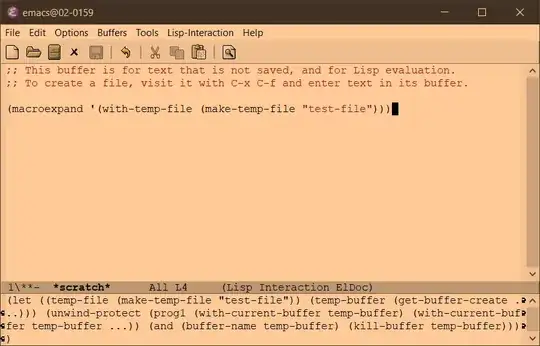

If I simply call macroexpand, the result is echoed in the minibuffer. When the expansion is large, the echo is all scrunched up:
(macroexpand '(with-temp-file (make-temp-file "test-file")))
I can go to *Messages* with C-h e, copy and paste it back into *scratch*, and then format it. But clearly that gets tiresome.

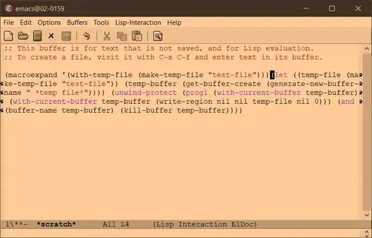

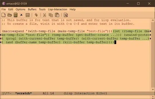

To save on the copy/paste, I have tried using eval-last-sexp with a universal argument, C-u C-x C-e. This indeed prints the output to the buffer...but it's in some weird interactive state that I cannot edit. Pressing RET causes it to alternate between an abbreviated and expanded form:
Abbreviated (expressions contain ellipses): enter image description here
Expanded (Placing point before the expansion and pressing RET causes the ellipses to expand and not insert a line break): enter image description here
After calling macroexpand, C-h k RET shows that elisp-last-sexp-toggle-display is now the binding for RET.

  • What NickD said. Expand the ellipsis mark the region of the result and call Edit -> Text Properties -> Remove Text Properties. If you don't want to use the menu bar you can call M-x facemenu-remove-all to remove the fancy text properties. – Tobias Feb 25 '20 at 15:53
