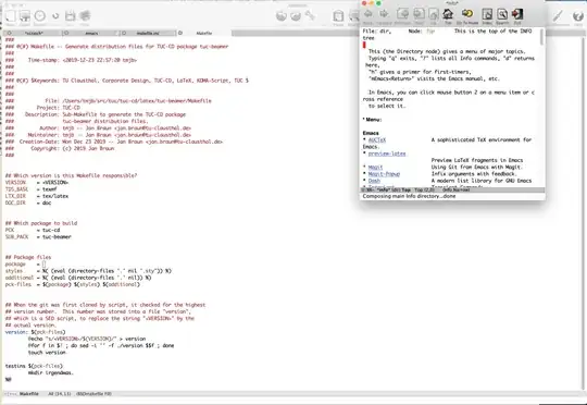

This image shows the location of the two frames, after having pressed C-h i. AS you can see, a new frame "* info *" was opened on top of the initial frame (which is now in the background). Please notice also, the width of the new frame is not sufficient, to view the text, without breaking some longer lines. Furthermore, I'd love to have the new frame on the left screen side.
Additional frame on top of initial frame

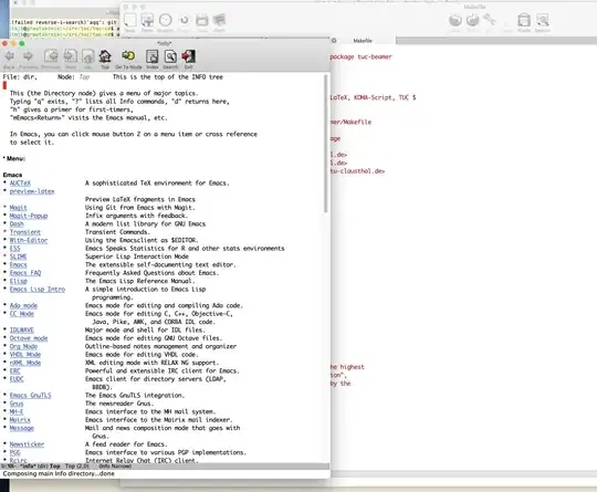

But I'd like to define the dimensions as well. That would save me to use the mouse, to correct their size and location. Something like this is desired:
Desired Size and location of the new frame
(Obviously, I picked the frame with the mouse, moved it to its desired location and resized it with the mouse. I'd love to avoid using the mouse, instead I want to add some lisp code to my ~/.emacs to do this changes for me!
If I press than C-h k TAB I get another frame as shown here. This should also open on the left screen side (and not on the right side, as shown here).
Next additional frame *Help*
What do I have to add, to my '~.emacs' file, in order to define the size ('width' x 'height') and location ('left' and 'top') of this kind of frames.
