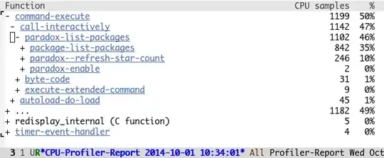

Profiling
Benchmark is good at overall tests, but if you’re having performance problems it doesn’t tell you which functions are causing the problem. For that, you have the (also built-in) profiler.
  1. Start it with M-x profiler-start.
  2. Do some time consuming operations.
  3. Get the report with M-x profiler-report.
You should be taken to a buffer with a navigatable tree of function calls.
Profiler screenshot
