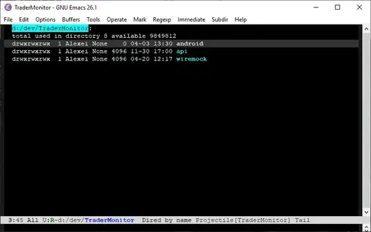

Emacs 26.1. , Dired+
Here content folder TraderMonitor in Total Commander:
and here how look same folder (TraderMonitor) in Emacs, dired mode:
How show hidden/system folders:

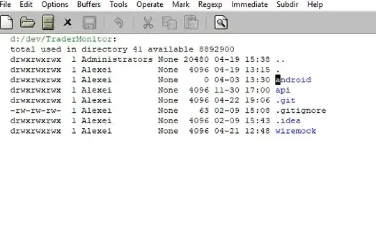

P.S. If I start by emacs -Q I see all this hidden files:
a_subscriber

What is the value of option dired-listing-switches? If you are telling ls not to list dot files ("hidden" files) then they will not be shown by Dired.
Do you have dired-omit-mode turned on? If so, what are the values of options dired-omit-files and dired-omit-extensions?
Even with vanilla Dired, file names with extensions such as .git are matched by the default value of dired-omit-extensions, so they will not show when dired-omit-mode is turned on.
Do you see the same behavior if you start Emacs without your init file: emacs -Q and you use only vanilla Dired? If you start Emacs without your init file and you use Dired+?
Dired is quite configurable, and Dired+ is even more so. Whether to show such files is up to you.
Drew
