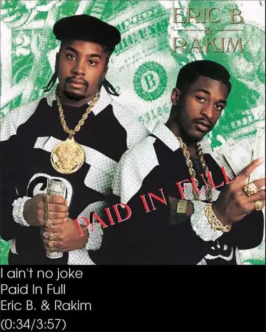

I am using GNU Emacs to display the cover of the album mpd is currently playing, inserting it into a *jukebox* buffer with this code:
(put-image (create-image albumartname 'imagemagick nil :width 1022) 0 albumartname)
(The window is maximized and the screen is 1024 pixels wide.)
I would like to have that image fill the entire width of Emacs' window, but a column of empty space always appears to the right of the image:
Picture in buffer, empty column to the right
The width of this column depends on the font size - if I turn down the font size to 1, there is just a tiny column of empty space. If I turn the font size up to 38, it is much wider.
I have tried both (visual-line-mode 1) and (toggle-truncate-lines 1), without any luck. I have turned scrollbars and fringes off.
Is there a way to coerce Emacs into not showing that column of empty space?

Here is a screenshot if I do:
(add-to-list 'default-frame-alist '(font . "URW Gothic L-1"))
(I have changed the background-color):
I tried the suggestion of setting
 (setq frame-resize-pixelwise t)
but that didn't help.
I have also tried to add an overlay with a face with height 1 to the picture, which I couldn't make work either.
Could it be a column reserved for the "truncate char"? If I make the window narrower, it looks like this:
Notice how the column has a "$" below the image, where the line is longer than the screen, so Emacs definitely can paint there.
Update 2
I have gotten a little further. If I set the default font size to 1:
and I define a face:
(defface jukebox-cover
  '((t (:family "URW Gothic L" :height 380 :foundry "urw" :slant normal :weight normal :width normal)))
  "Jukebox cover workaround face"
  :group 'jukebox-mode)
And then after displaying the image and putting the text in the buffer:
    (put-image (create-image albumartname 'imagemagick nil :width 1020) 1 albumartname)
    (insert (format "\n%s\n%s\n%s " title album artist))
I then add and overlay with the face I defined:
        (overlay-put (make-overlay (point-min) (point-max)) 'face 'jukebox-cover)
then it looks like this:
Now I just need to figure out how to make the minibuffer font readable again as well.

Ok, I finally got a work around that [almost] works. This is what I had to do:
1 Set the font size to 1
2 Add an overlay to the entire buffer that increases the font size
and
3 Add a hack to increase the font size in the minibuffer (from http://ergoemacs.org/emacs/emacs_minibuffer_font_size.html):
(dolist
    (buf (list " *Minibuf-0*" " *Minibuf-1*" " *Echo Area 0*" " *Echo Area 1*" "*Quail Completions*"))
  (when (get-buffer buf)
    (with-current-buffer buf
      (setq-local face-remapping-alist '((default (:height 380)))))))
The result looks like this:
I call it a work around because it's not elegant, and there is still a 1 pixel column to the very right of the image.
