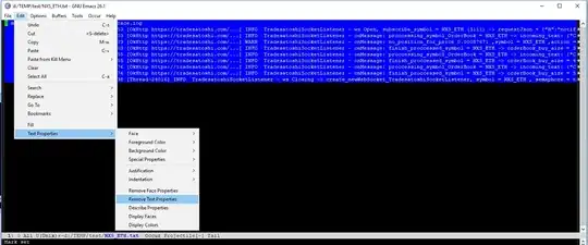

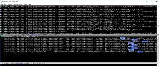

I open file trace.log. User occur to find text. Save occur buffer to file NXS_ETH.txt. Do some manipulations. See screenshots. But I can't edit EDITABLE file.
Here steps: enter image description here
Save occur buffer to file: enter image description here
File is EDITABLE (not read-only).
Remove Face and text properties: enter image description here enter image description here
I press "a" but char "a" not show in buffer. I get message on minibuffer:
a is undefined
What is this?
To fix this I reopen file NXS_ETH.txt and then success edit buffer.
Why I can't input any text after save occur buffer to the file?
