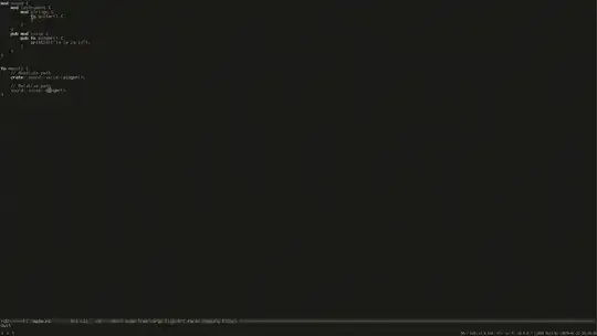

I'm using emacs from a terminal, and have noticed that certain commands make the terminal screen flicker when I use them.
Notable commands are evil mode's recenter-top-bottom and xref-find-definitions
This must surely be possible, as xref-pop-marker-stack, a command that has a very similar function as xref-find-definitions, does not have this issue. The whole terminal is not updated and doesn't give a flicker.
Is there any way of stopping this from happening? The flicker is quite annoying. This only appears to happen when emacs is run inside of a terminal.
