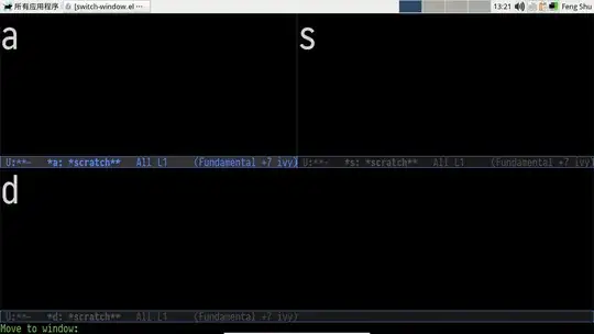

I use switch-window. When switching windows, it labels each window with a key and then prompts for which one you want. There are several options, but I prefer to use the home row for the labels.
switch-window
You can use (setq switch-window-multiple-frames t) to have it span multiple frames.
My init.el looks like:
(use-package switch-window
  :ensure t
  :bind
  ;; default C-x o is other-window
  ;; default C-x C-o is delete-blank-lines
  (("C-x o" . switch-window)
   ("C-x C-o" . switch-window))
  :config
  (setq switch-window-shortcut-style 'qwerty)
  ;; when Emacs is run as client, the first shortcut does not appear
  ;; "x" acts as a dummy; remove first entry if not running server
  (setq switch-window-qwerty-shortcuts '("x" "a" "s" "d" "f" "j" "k" "l" ";" "w" "e" "r" "u" "i" "o" "q" "t" "y" "p"))
  (setq switch-window-increase 3))
A minimal setup would look like:
(require 'switch-window)
(global-set-key (kbd "C-x o") 'switch-window)
Minimal setup with multiple frames
