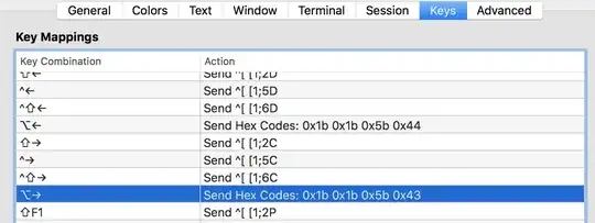

I'm looking to configure iterm2 to output the correct hexcodes that correspond to in emacs.
There's a whole bunch of mappings predefined but it's very cryptic.
I'm a little bit lost as to how these mappings are translated and if there is a table of how these mappings work.

You can add:
For C-M-left: Send escape sequence: [1;7D
For C-M-right: Send escape sequence: [1;7C
For C-M-up: Send escape sequence: [1;7A
For C-M-down: Send escape sequence: [1;7B
And this will work with Emacs if you set the term in iTerm2 to be reported as xterm.

Back to iTerm2 Key Mappings
What you see in iTerm2's Key Mapping are all those additional mappings for stuff that fall outside the ASCII range. Though I think you could also use it to remap how iTerm2 maps the normal keys even within the ASCII range if you wanted.
You have two useful settings:
  1. Send hex codes
This lets you tell iTerm2 that a specific keyboard shortcut should send the following sequence of ASCII characters (where it takes the ASCII chars in their hexadecimal representation).
So refer too: https://www.barcodefaq.com/ascii-chart-char-set/ to see the hex code for each ASCII character.
With that you can tell iTerm2 to send any arbitrary sequence of ASCII characters for any arbitrary keyboard key press event.
  1. Send escape sequence
But generally, terminals like xterm have used a sequence of ASCII characters that always starts with the ASCII Escape character ^[ which is ASCII decimal 27 or ASCII hex 0x1b.
Because that's so common, iTerm2 has a "Send escape sequence" where it lets you type the ASCII characters using your keyboard (so you can input them as text instead of hex or decimal) which it will automatically prepend with the ASCII Escape char or ^[ aka ASCII decimal 27 or hex 0x1b.
