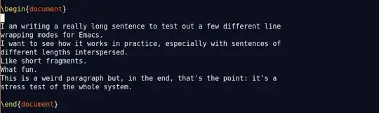

If you just want something like visual-line-mode but configurable, you can try longlines-mode which is what I use for most of my prose. longlines-mode wraps your text similarly to visual-line-mode with the width configured by fill-column.
Here's a screenshot with fill-column set to 70 (the window actually extends even more to the right).
An example of longlines-mode wrapping text.
