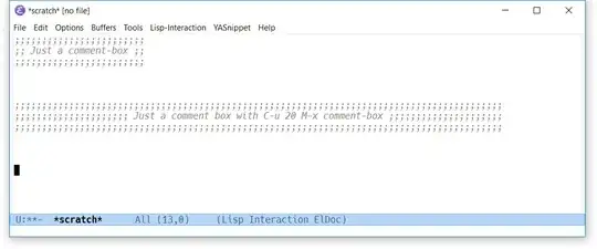

While not exactly what you need but...
You can try comment-box command together with C-u 20 prefix (or whatever number you want):
You can also write your own function to do it (just grab the sources of the comment-box and try to adjust it to remove 1st and last comment lines + add padding you need).
