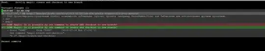

Now what it looks like in Magit:
As you can see Magit says that the difference was in WHOLE line. It's not showing where the difference is within the line. So I need to find where is the difference manually. I need to do this every time. It's not very comparable. Suppose I have differences in 20 lines. I need to spend a lot of time to find what actually changed. It's not very good.
