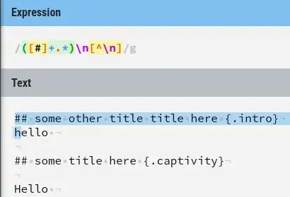

My attempt at regex has so far been
[#]+.*\n[^\n]
This is at least able to identify every title that is missing a newline underneath.
However, I have no idea how I would use the expression above to insert a newline after the title. Any help would be appreciated.

  • I don't know what that screenshot is of, but you should be using M-x re-builder otherwise how can you tell if you're using appropriate syntax? See also https://emacs.stackexchange.com/q/5568/454 – phils Apr 09 '19 at 04:23
