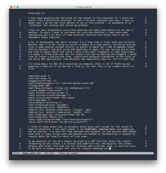

I'm using Emacs for Mac 25.3 installed via Homebrew. After a lot of fiddling and googling I have set it up the way I like it, for now. This is my ~/emacs.d/init.el file:
(menu-bar-mode 1)
(tool-bar-mode -1)
(toggle-scroll-bar -1)
(set-frame-parameter nil 'internal-border-width 20)
(fringe-mode 100)
(set-face-attribute 'fringe nil :background nil)
;;(setq header-line-format "20")
(setq inhibit-startup-screen t)
(setq initial-scratch-message "")
(setq initial-major-mode 'text-mode)
(enriched-mode 1)
(setq-default word-wrap t)
(set-foreground-color "grey80")
(set-background-color "#2d3743")
(add-to-list 'default-frame-alist '(height . 60))
(add-to-list 'default-frame-alist '(width . 85))
(set-frame-position (selected-frame) 225 35)
(set-frame-font "Menlo 13")
(setq ispell-program-name "/usr/local/bin/aspell")
(setq ispell-dictionary "en_GB-ise-w_accents")
I think it looks great and, it actually works quite well except for the issues in need of solutions. I can spell check, I can highlight, meaning bold, and underline and do italics. I've held off from implementing Flyspell for now because many people have said it slows things down and because one method of implementing it appears to require about 50 lines (or more) of Lisp code. BTW, you will notice on line 7 of my config file that I attempted to set a top border but could not get it to work. Instead I used "internal-border-width" which gives me a bigger space below the mode line but that doesn't bother me.
My current Emacs setup
So my question is: How do I export my prose to a PDF file and retain the simple formatting on the screen; i.e italics and underline etc. And margins. The screen margins and screen line wrap are not retained when printing. Also, it would be nice to be able to change output font size for chapter headings etc. And, I suppose I do need to set an output/print font for the PDF, but that could be a fixed default. One last thing, is it possible to get rid of the little curly arrows at the margins. They seem completely superfluous to me.

  • https://stackoverflow.com/questions/27845980/how-do-i-remove-newline-symbols-inside-emacs-vertical-border this should help with line wrap indicators. – wvxvw Jun 21 '18 at 13:16

I'm not sure what you've tried, but the best start would probably be ps-print-buffer-with-faces. This answer provides a convenient wrapper for generating a pdf file (copied below):
You can put the below in your init.el and bind the function to a binding of your choice.
The function prints the file in current buffer as a PDF in the same folder by default.
Here the function requires the binary ps2pdf for converting .ps to .pdf. But you can replace that with any available pdf generator on your system.
(require 'ps-print)
(when (executable-find "ps2pdf")
  (defun modi/pdf-print-buffer-with-faces (&optional filename)
    "Print file in the current buffer as pdf, including font, color, and
underline information.  This command works only if you are using a window system,
so it has a way to determine color values.
C-u COMMAND prompts user where to save the Postscript file (which is then
converted to PDF at the same location."
    (interactive (list (if current-prefix-arg
                           (ps-print-preprint 4)
                         (concat (file-name-sans-extension (buffer-file-name))
                                 ".ps"))))
    (ps-print-with-faces (point-min) (point-max) filename)
    (shell-command (concat "ps2pdf " filename))
    (delete-file filename)
    (message "Deleted %s" filename)
    (message "Wrote %s" (concat (file-name-sans-extension filename) ".pdf"))))
Line wrap
Unfortunately, I don't think that there's any way to export the "soft"/visual line breaks (indicated by the curly arrows in the margins). I'd instead suggest using auto-fill-mode with the fill-column set to an appropriate value (with set-fill-column or (setq fill-column N)).
Margins
I don't think there's any in-built way to use the value of the fringes (in the display) to set the margins in the printed document. You can however set the printed margins manually; the relevant variables are: ps-top-margin, ps-left-margin, ps-right-margin, ps-bottom-margin, which you can set with setq or "customize" (M-x customize-variable RET NAME_OF_VARIABLE).
Print header
If the default print header annoys you, you can switch it off with (setq ps-print-header nil) or modify it (details in the docstring of the variable — C-h v ps-print-header).
Font sizes
You can set the font size, using the variable ps-font-size and the font family using ps-font-family (though in the case of the latter, if the font family is not in ps-font-info-database, you'll need to customise the latter — if you look at the default value of the variable, the format of the database is pretty self-explanatory).
However, I don't think that it's possible to set the size of chapter headings etc.
htmlize
Using htmlize as suggested by this answer might also be an OK-ish solution — in particular it would deal better with font sizes, but it still can't export soft line breaks or the margins — though it depends on an external package.
Alternatives
