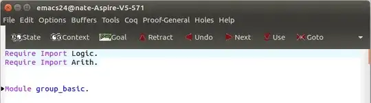

I'm in a situation where I would like to look through a lot of text files as they are being created.
I would like to configure Emacs to do the following:
  1. Launch from a script with directory argument
  2. Open the oldest file in directory
  3. Have two buttons; "Next" switches the current buffer to the oldest younger file and "Prev" would switch to the youngest older file.
I'm imagining that it would look like the "undo/next" buttons from this picture of Proof General:
Picture of the GUI of Proof General
How do I go about doing this? Is it even possible?

  • This doesn't seem to work for me. It doesn't actually open a file in the directory passed as a command line argument, it opens a file in the working directory. Yet it fails if the directory argument isn't there. Also, the file that it opens weirdly isn't the absolute oldest according to Nautilus's "Sort by date modified" feature. Once it opens, I see the buttons but they aren't activated. – firstname gklsodascb Jun 17 '18 at 13:41
  • When I do M-x and try "cycle-dir-next" I get "Symbol's function definition is void: when-let" – firstname gklsodascb Jun 17 '18 at 13:47
  • @firstnamegklsodascb The image in your question suggests that you are still using emacs24. Is that right? I've tested the stuff with emacs25.1.50.2. For emacs 25.1.50.2 when-let is contained in the package subr-x. https://github.com/jkitchin/scimax/issues/55 suggests that emacs24 does not have when-let. Let's see whether we can do without it. – Tobias Jun 17 '18 at 13:55
  • Yes, I'm still on emacs24. – firstname gklsodascb Jun 17 '18 at 14:22
  • @firstnamegklsodascb I've removed when-let and fixed some bugs. Could you try again? – Tobias Jun 17 '18 at 15:16
  • @firstnamegklsodascb I've added two more (optional) options: --cycle-dir-predicate: name of predicate function for sorting; --cycle-dir-filter: regular expression for filtering the file names. Ony the filtered file names are cycled. – Tobias Jun 17 '18 at 15:32
  • That works. This example code will be very useful. Thanks a lot. – firstname gklsodascb Jun 17 '18 at 18:43
