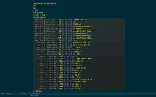

Additionally you can use dired-subtree from dired-hacks repo.
Here you have short demo and screenshot from my setup where I press i to drill down folder and ; to go back.:
  (define-key dired-mode-map "i" 'dired-subtree-insert)
  (define-key dired-mode-map ";" 'dired-subtree-remove)
dired-subtree

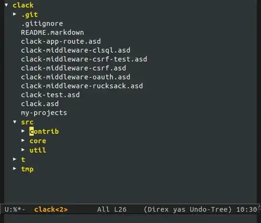

PS I'm also aware of direx which looks like that: direx:

  • I've tried dired-subtree but the tree structure wasn't as visually apparent as I was looking for. Direx looks perfect tho, I'm gonna go try it. – Avdi Sep 29 '14 at 22:40
    I'm this one because the suggestion of Direx looks ideal for my use case of putting a directory tree visualization front and center. That's not to discount @keelerm's excellent suggestions though. – Avdi Sep 29 '14 at 22:49
  • You can get equivalent functionality using one key binding: (define-key dired-mode-map "i" 'dired-subtree-toggle). I like to map it to "C-c i" though since dired also does insert subdirectory using "i". – Joe Oct 06 '19 at 20:47

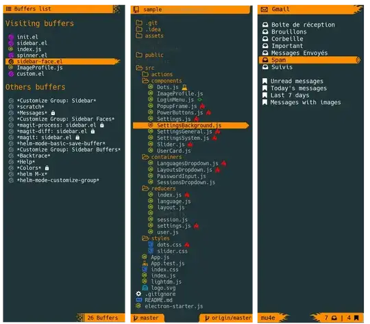

Take a look at sidebar.el.
As the repo said, it is is a customizable file explorer with git integration, but not only that. You can also get the list of buffers and your maildirs with mu4e.
