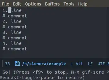

Not built in but another package for this is called objed (I'm the author). You can mark any text object with m the point is moved to the next object of current type automatically. Unmark any object by navigating to it and press m again. Here is an example screencast:
