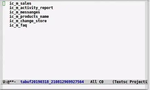

Suppose I have the following text (about 100 rows):
   ic_m_sales
   ic_m_activity_report
   ic_m_messanges
   ic_m_products_name
   ic_m_change_store
   ic_m_faq
How to add the same suffix (_inactive) to every line of the text ? The result must be like this:
   ic_m_sales_inactive
   ic_m_activity_report_inactive
   ic_m_messanges_inactive
   ic_m_products_name_inactive
   ic_m_change_store_inactive
   ic_m_faq_inactive

A little complement to make @YoungFrog answer a bit more practical.
Clearly at the end of the lines there might be some random white spaces you not even notice. Not clearing them means replaced text is randomly like that:
ic_m_sales           _inactive
ic_m_activity_report     _inactive
ic_m_messanges         _inactive
ic_m_products_name  _inactive
ic_m_change_store        _inactive
ic_m_faq            _inactive
Clearing the spaces is even more boring than adding the suffixes.
However, you can select the region to suffix and use the command C-M-% or M-x query-replace-regexp, then just type:
SPACE*$ENTER_inactive
Now you are replacing the spaces before the newlines, if any.
