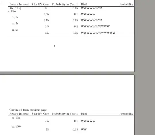

When exported to markdown format this long table shows up just fine and perfectly formatted; however, when I export to PDF I get something very ugly:
  1. The table runs off the width of the page.
  2. The table runs into the second page.
Here's what it looks like:
Question: Is there a way to force this table to at least not run off the width of the page?

Put this code above your table:
#+ATTR_LATEX: :environment longtable :align |l|l|l|l|l|l|l|l|
You can replace the l with p{*cm} where * can be any numeral as required to fit table to page. e.g.
#+ATTR_LATEX: :environment longtable :align |p{3cm}|p{6cm}|l|l|l|l|l|l|
Please also see
You would be able to solve your problem with above links.
Easiest non-coder way around can be to "export file as HTML" and "print as PDF" from browser.
