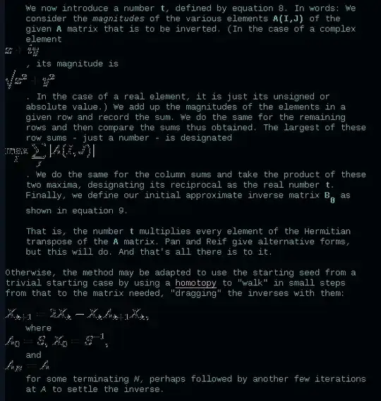

I saw this question: How to customize background color for some web pages opened with eww? but this won't work for me. I'm trying to read Wikipedia pages and in many places Wikipedia uses images to render mathematical formulae. When these have transparent background, the appear not to render acceptably (example below). So, I'd like to have white-ish background theme for eww, while keeping everything else with a dark-background theme.

Alternatively, if you are comfortable with reading LaTeX markup, you might prefer to configure wikipedia to not use images for rendering math. This requires you to create a wikipedia account, then go to Preferences->Appearance->Math to select an option. I would recommend "Client-side MathJax", since this will render prettily in a browser that understands javascript, but will just show the LaTeX source in a browser like eww that does not.
For instance, your page looks like this for me: enter image description here

deprecated
  • 2,805
  • Maxima's Emacs binding kind of does it (it renders LaTeX in the colors of the current theme). I might look into how it does it to maybe incorporate that. Funny, I actually ended up doing both, (disabling the server-side rendering in Wikipedia) and adding a hook to eww, but I'm going to accept Constantine's question because it's more generic. Thank you though! – wvxvw Dec 11 '14 at 06:29
