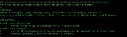

After writing functions in C/C++, I like to format my block comments that explain a function's purpose, parameters, use, and so on.
(See example below) Desired Emacs Comment Style
However, to indent my comments in emacs, I need to do C-q TAB, which is a bit of an awkward set of keystrokes (not to mention having to press three keys as opposed to one).
My question is: what would the Elisp code be for:
  1. See whether or not what I'm typing is in a comment block (I'm thinking it has to do with font-lock-comment-face but I'm not sure
  2. If the text is inside a block comment, have TAB perform the same functionality as the aforementioned C-q TAB
For more information, some of the shortcuts given in the Emacs guide, such as M-j are helpful, but I still need to C-q TAB to initially indent a region within the comment.
