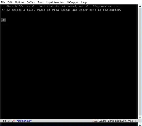

I want to do some arithmetic operation I do this: enter image description here
The result is in the echo area, but I want the result to be in cursor place in the buffer. Something like this:
How do I do this?

    It's good, but it not enough. If I use command C-u C-x C-e the result will be (* 60 3)180. But I need only 180 (as in my screenshot). – user8542613 Sep 09 '17 at 13:03
    @user8542613 : then you will need to write your own command. – Dan Sep 09 '17 at 13:12
