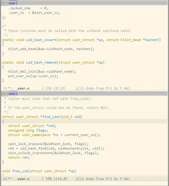

Emacs windows
C-x 2 will open another window (=split the frame) below the current one, attached to the same buffer. You can move point in either window without affecting the other.
You can move from one window to the other using C-x o. The built-in windmove library provides some function that makes navigating between windows easier.
If this method suits you, you may also want to have a look at indirect buffers.

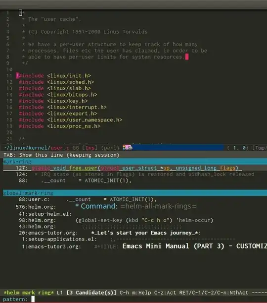

In addition to phils's answer, there are some more options:
  • helm-all-mark-rings: It allows you to view the content of the both the local and global mark rings in a friendly interface, so you can always jump back to where you were. You can push mark with C-SPC C-SPC. Demo:
helm-all-mark-rings
  • helm-semantic-or-imenu: List all available definitions in the current file. If cursor is inside a definition, when activating the highlighter preselects that definition.
