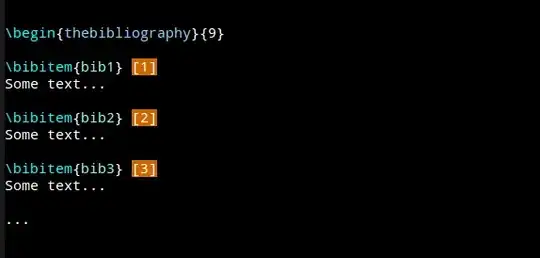

Ok, I accepted the Drew's answer but I want also to share the complete solution I finally adopted.
This is the code:
(defun BibitemNumbering ()
  (interactive)
  (save-excursion
    (let ((counter 0))
      (while (search-forward-regexp "\\\\bibitem{[^}]+}\\(\n\\)" nil t)
    (save-excursion
      (let ((b (make-marker))
        (e (make-marker))
        STRING)
        (setq counter (1+ counter))
        (set-marker b (match-beginning 1))
        (set-marker e (point))
        (setq BibNumberOverlay (make-overlay b e))
        (setq STRING (propertize (concat "[" (number-to-string counter) "]") 'face '(:background "DarkOrange3" )))
        (setq STRING (concat " " STRING "\n"))
;       (put-text-property b e 'display STRING)
        (overlay-put BibNumberOverlay 'display STRING)
and this is the result:
