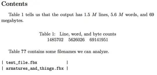

After running org-latex-export-to-pdf, I see the following
Ok, the uderscores in the filenames are causing LaTeX to typeset the names with subscripts, not what I want. So I add ONE line:
Table [[tab:line-word-byte-count]] tells us that the output
has $1.5~M$ lines, $5.6~M$ words, and $69$ megabytes.
#+NAME: tab:line-word-byte-count
#+CAPTION: Line, word, and byte counts
| 1485702 | 5626026 | 69141951 |
Table [[TestFiles]] contains some filenames we can analyze.
#+ATTR_LATEX: :mode verbatim
#+NAME: TestFiles
#+CAPTION: List of files names.
| test_file.fbx            |
| armatures_and_things.fbx |
and the caption AND the reference disappear, but the contents get typeset correctly. It doesn't matter where I put the ATTR_LATEX, before or after the NAME or CAPTION. Any of the six permutations of those three lines gives me the same bad results.
It seems that I can have EITHER captions and references OR verbatim contents, but not both. I'd be grateful for any advice.

Looking at the .tex file you produce, setting :mode verbatim prevents org from wrapping the result in \begin{table} and \end{table} in the export. You can achieve the desired result by omitting the #+attr_latex line and using Org markup inside the table:
#+NAME: TestFiles
| =test_file.fbx=            |
| =armatures_and_things.fbx= |
Edit: in response to some more clarification.
You can disable the automatic formatting of the underscores with #+options: ^:nil. This may be enough to display and reference the table, but you can also get the monospace font by defining a custom column (you also need to load the array package in latex). Full example:

#+ATTR_LATEX: :align >{\ttfamily}l
#+NAME: TestFiles
| test_file.fbx            |
The downside of this is that you have to give up subscripts in the rest of your document. I thought maybe there was a way to limit this to a subtree with the EXPORT_OPTIONS but I couldn't get it to work. You can also play with the value of org-export-with-sub-superscripts (see https://emacs.stackexchange.com/a/10620/14373) if you're okay with using braces when you actually want Org to interpret an underscore as a subscript.
