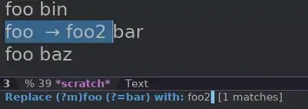

https://github.com/benma/visual-regexp-steroids.el/
Visual regexp steroids allows you to replace, search, etc. using python regex. Python regex has support for look ahead and look behind.
It even highlights the regexp expressions for you.
