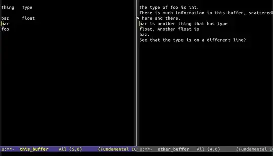

Right now, I have my Emacs frame vertically split, and am looking at two different buffers in the two windows.
I'd like to go to a word in one buffer, hit some keys, and have the ocurrences of that word (if any) highlighted in the other buffer, scrolling to it if necessary.
Is there a way to do that?
Screenshot to explain
In the screenshot above, with my cursor just before "bar" in the left buffer, I'd like to be able to <do something> and quickly see where "bar" is in the right buffer.

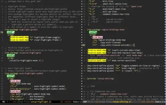

You can use a package called highlight-global that's available from github but not on Melpa (as of writing this).
The highlight-frame-toggle function defined in this pacakge will highlight the word at point or the selected region everywhere in the frame (in all the buffers). This, though, would not do the autoscroll to the highlighted word that you need. It picks a different highlighting color as you highlight more words without clearing the earlier hightlights.
Here is a screenshot of what it looks like:
enter image description here Click for better view of the screenshot

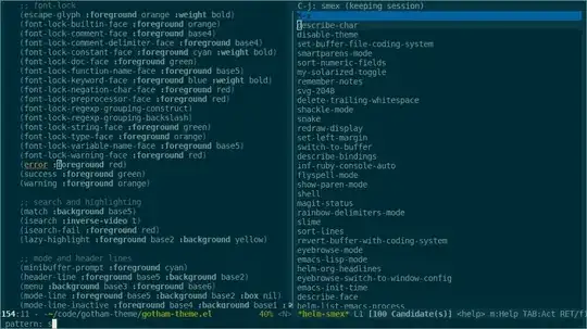

helm has interfaces that can accomplish this goal, I've recorded a Gifcast to demonstrate the helm-swoop package:
After starting the helm-swoop search I can either narrow down to less candidates by entering further space-separated tokens or hit C-p and C-n to switch to the next one and scroll in the target buffer at the same time.

  • As I said in the question, the occur-based solutions are not what I want, because they list matching lines (and I have to further go there and interact with the list) instead of keeping the other buffer intact and highlighting the text in it. – ShreevatsaR Nov 06 '14 at 20:27
  • Hmm, the other buffer is kept intact and can show you context, but if the highlights are what you're after, helm-swoop might be more your thing. – wasamasa Nov 06 '14 at 20:34
  • OK, edited it to demonstrate helm-swoop. – wasamasa Nov 06 '14 at 20:41
  • I wish I could make myself clearer. During the entire process, I don't want the other window to ever display anything other what it's currently displaying. All I want is to hit a keystroke and see in the other window, as it is, the (first, say) occurrence of the current word in the other buffer. (In my screenshot, when my cursor is at "bar" in the left buffer, I want to hit a key and be able to see where "bar" occurs in the right buffer, with the right still displayed the same.) Equivalent to hitting C-s C-w C-x o C-s C-s C-x o (which is what I'm using now, and seems fine actually). – ShreevatsaR Nov 06 '14 at 21:41
  • If helm could highlight all the occurrences in the other buffer (while still scrolling so that the first one is visible on screen), then that would make it better than the macro bound to the sequence of those 8 keystrokes. :-) – ShreevatsaR Nov 06 '14 at 21:48
