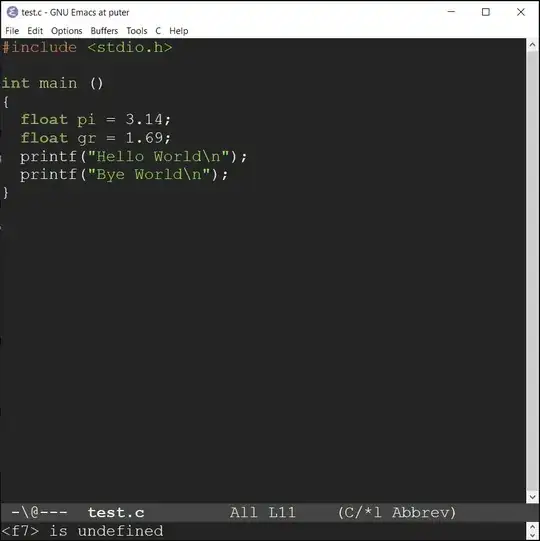

I've tweaked above answers with better logic and tested it, working perfectly:
  1. Add Hooks to functions:
  (add-hook 'compilation-start-hook 'compilation-started)
  (add-hook 'compilation-finish-functions 'hide-compile-buffer-if-successful)
  1. Auto Hide Compile Buffer Delay Customizable Variable (via M-x customize-variable RET auto-hide-compile-buffer-delay):
  (defcustom auto-hide-compile-buffer-delay 0
    "Time in seconds before auto hiding compile buffer."
    :group 'compilation
    :type 'number
  1. Get time taken in compilation and use compilation-num-* for warnings and errors count in compilation buffer:
  (defun hide-compile-buffer-if-successful (buffer string)
    (setq compilation-total-time (time-subtract nil compilation-start-time))
    (setq time-str (concat " (Time: " (format-time-string "%s.%3N" compilation-total-time) "s)"))
(if
  (with-current-buffer buffer
    (setq warnings (eval compilation-num-warnings-found))
    (setq warnings-str (concat " (Warnings: " (number-to-string warnings) ")"))
    (setq errors (eval compilation-num-errors-found))
    (if (eq errors 0) nil t)
  ;;If Errors then
  (message (concat "Compiled with Errors" warnings-str time-str))
  ;;If Compiled Successfully or with Warnings then
  (progn
    (bury-buffer buffer)
    (run-with-timer auto-hide-compile-buffer-delay nil 'delete-window (get-buffer-window buffer 'visible))
    (message (concat "Compiled Successfully" warnings-str time-str))
(make-variable-buffer-local 'compilation-start-time)
(defun compilation-started (proc) (setq compilation-start-time (current-time)) )
Demo
