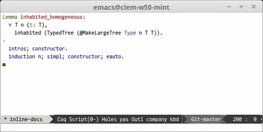

How to make an overlay in Emacs like the following (maybe it's not overlay, I don't know, it's from company-coq inline-docs):
overlay like this screencast
stardiviner
  • 1,928
  • 28
  • 46
Indeed it does accomplish that behavior using overlays. Specifically- it uses the 'after-string property to show the documentation (see: Overlay Properties).
If you examine the function company-coq--show-definition-overlay-at-point (ex: via M-x find-function) you can see exactly how it's created:
(setq company-coq-definition-overlay (make-overlay ins-pos ins-pos))
(overlay-put company-coq-definition-overlay 'after-string ins-str)
A reference to the overlay is kept in company-coq-definition-overlay to make it easy to remove the overlay later:
(delete-overlay company-coq-definition-overlay)
(setq company-coq-definition-overlay nil)
ebpa
  • 7,449
  • 29
  • 55
  • With (overlay-put OVERLAY 'after-string STR) does not have fontify as in screencast. – stardiviner Jan 19 '17 at 03:49
  • @stardiviner are you wondering about specific characters/colors/style? You could use the edebug to examine the string ins-str in company-coq--show-definition-overlay-at-point. Specific faces and styling will exist as text properties in that string. Text Properties: Special Properties is a helpful reference for decoding those properties. – ebpa Jan 19 '17 at 18:45
