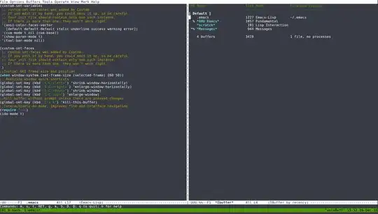

This might have an obvious answer but I've been trying to fix this issue with no luck. (I'm new to Emacs)
Whenever I start Emacs within a Tmux pane, it ignores some of my .emacs settings. These are the contents of the .emacs file:

Settings like IDO mode and kill-this-buffer work fine. But the syntax color scheme and S-C-arrows for resizing the window don't work.

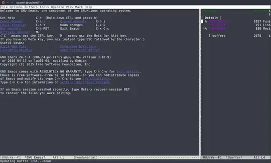

Inside Tmux: enter image description here Outside Tmux (still in gnome-terminal): enter image description here

  • How do you know it ignores the configuration? – choroba Dec 19 '16 at 15:09
  • The only thing that seems to be working from my configuration mode is Ido mode. Other than that my syntax theme doesn't work, my custom keybindings don't work and changing settings in the init file like menu-bar-mode -1 doesn't work. It does work in a regular terminal though. – Rtsne42 Dec 19 '16 at 15:26
  • Does M-: (getenv "HOME") point to your user's home directory? – wvxvw Dec 19 '16 at 15:31
  • Yes, it does. I killed all the Tmux sessions and some of the new keybinds seem to work now. – Rtsne42 Dec 19 '16 at 15:34
  • But things like my window resize keybinds and syntax theme don't work: (global-set-key (kbd "S-C-<left>") 'shrink-window-horizontally) (global-set-key (kbd "S-C-<right>") 'enlarge-window-horizontally) (global-set-key (kbd "S-C-<down>") 'shrink-window) (global-set-key (kbd "S-C-<up>") 'enlarge-window) – Rtsne42 Dec 19 '16 at 15:35
  • I do realise that i just discovered that some of them do work. I'll update the post. If I start emacs in the terminal I can resize windows with S-C-arrows and syntax highlighting is different. When I start it in Tmux these settings don't work. – Rtsne42 Dec 19 '16 at 15:38
  • Updated the post. – Rtsne42 Dec 19 '16 at 15:43
  • The "outside" screenshot is the so-called "graphical" environment (Emacs runs on top of something like Xorg). Most themes for Emacs have different colors for graphical and non-graphical environments (try running Emacs from a regular terminal emulator like this: emacs -nw to see that this will also happen outside tmux. – wvxvw Dec 19 '16 at 16:02
  • @wvxvw The second screenshot is inside gnome-terminal not the GUI version. I'll update it. – Rtsne42 Dec 19 '16 at 16:03
  • Ah, I got confused because the fringe looked "3D". – wvxvw Dec 19 '16 at 16:06
  • Are you sure your terminal or tmux don't "understand" some of the keybindings for themselves? – choroba Dec 19 '16 at 16:33
