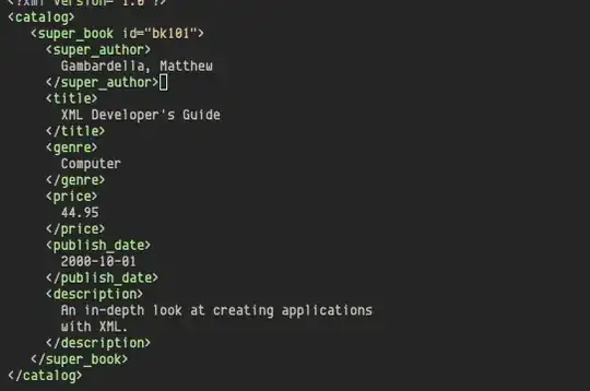

I found this SO post: https://stackoverflow.com/questions/944614/emacs-does-hideshow-work-with-xml-mode-sgml-mode
(require 'hideshow)
(require 'sgml-mode)
(require 'nxml-mode)
(add-to-list 'hs-special-modes-alist
             '(nxml-mode
               sgml-skip-tag-forward
               nil))
(add-hook 'nxml-mode-hook 'hs-minor-mode)
;; optional key bindings, easier than hs defaults
(define-key nxml-mode-map (kbd "C-c h") 'hs-toggle-hiding)
You can use the code from there, slightly modified, for nxml-mode easily.
This will allow you to toggle hiding/unhiding of xml elements with C-ch and will support underscores in the names.

  • Brilliant! It also looks like it will be easy to write custom functions for hideshow like scanning a buffer to toggle all instances of a given tag etc. Would also be nice if clicking on an ellipsis with a mouse would un-hide, but I'll try not to shave the yak too much :) – Mark Nov 06 '14 at 05:21
  • @MarkAufflick hideshow has mouse support, by default, shift + mouse 2 is bound to hs-mouse-toggle-hiding, which should work exactly like you want it to. – Jordon Biondo Nov 07 '14 at 14:11
