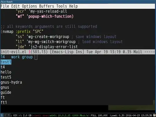

This is a interesting question. Several years ago I investigated all the solutions. Only workgroups2.el is heavy weight enough to cover all the corner cases.
But workgroups2 UI is a disaster. For example, if you enable worksgroup-mode (as its README suggested), the previous layout will be automatically loaded during emacs startup. That make startup extremely slow EVERY time.
My solution is to treat workgroups2 as a collection of API instead a usable tool out of box. So I change its default UI interaction by using ivy-mode (https://github.com/abo-abo/swiper) from @abo-abo
Toggle full window is easy, use APIs from winner-mode is enough.
Here is the complete code (I only use M-x toggle-full-window, M-x wg-create-workgroup and M-x my-wg-switch-workgroup, you also need install swiper, as I mentioned above),

UPDATE: I'm the maintainer of workgroups2 now. You don't need above hack any more.
Use wg-create-workgroup to create a new work group and save it, use wg-open-workgroup to open saved workgroup.
