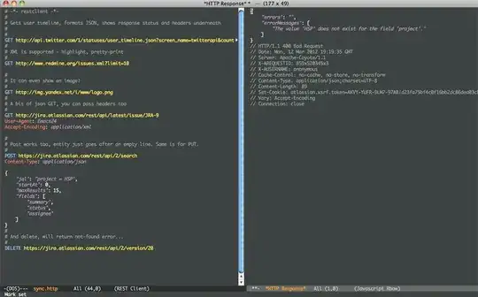

  • restclient is the most "interactive" mode.
    This is a tool to manually explore and test HTTP REST webservices. Runs queries from a plain-text query sheet, displays results as a pretty-printed XML, JSON and even images.
    restclient
    You can check a workflow example at http://jakemccrary.com/blog/2014/07/04/using-emacs-to-explore-an-http-api/.

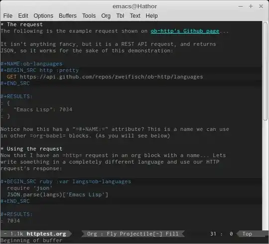

Old question, yes... But in the event that anyone Googles this; another option is using Org Babel and ob-http... (Can be installed from melpa.)
With org-babel, you can make an .org file containing "http" code blocks. When these blocks are evaluated, they will make the HTTP request and return the response as the result.
If these blocks have a "#+NAME:" attribute, you can use their results in any other org-babel block. This allows for some pretty neat literate programming using the results of HTTP requests.
For example, here is a little Org document demonstrating making an HTTP request and parsing the returned JSON in Ruby:
* The request
The following is the example request shown on [[https://github.com/zweifisch/ob-http][ob-http's Github page]]...
It isn't anything fancy, but it is a REST API request, and returns
JSON, so it works for the sake of this demonstration:
#+NAME:ob-languages
#+BEGIN_SRC http :pretty
  GET https://api.github.com/repos/zweifisch/ob-http/languages
#+END_SRC
#+RESULTS:
:   "Emacs Lisp": 7034
Notice how this has a "=#+NAME:=" attribute? This is a name we can use
in other =org-babel= blocks. (As you will see below)
* Using the request
Now that I have an =http= request in an org block with a name... Lets
write something in a completely different language and use our HTTP
request's response:
#+BEGIN_SRC ruby :var langs=ob-languages
  require 'json'
  JSON.parse(langs)['Emacs Lisp']
#+END_SRC
#+RESULTS:
: 7034
The =:var= keyword allowed me to assign the "=langs=" variable in the
Ruby block to the result of the =ob-languages= block [[The request][above]].
This didn't have to be in Ruby, this could have been any language,
including another =http= block.
This is what this looks like in org-mode: ob-http in org-mode
Hitting C-c C-c on the bottom block (The Ruby one) will automagically evaluate the top one for its dependency (That's the :var bit in the block's header.). This will mean that the http request is made first, and then the results are passed to Ruby for further processing.

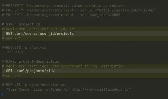

Mixing two interesting aproaches, restclient and org-babel, there is also the ob-restclient package. Interestingly, as an org code block can get arguments from other code blocks or variables, and in the header arguments can embed jq postprocessing commands.
In this example the project-id in the second query comes from the first query result. There are also some globally defined tags:
Some ob-restclient examples
