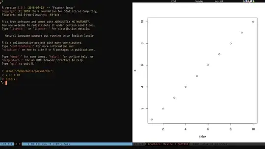

I just posted an answer to the old post you are referring to in your question. As I wrote there, this may not work for you since it would be quite a dramatic change in your overall computer workflow.
But exwm, by allowing any non-emacs window to be an emacs buffer, allows to have R plots in emacs buffers which are controlled by the usual emacs settings and keybindings.
Here is an example of what this looks like:
prosoitos
  • 205
  • Could you share your config to achieve this? Looks very nice! Thanks. – Maikol Solís Apr 19 '22 at 15:47
  • Hi Maikol, I now use i3-wm, so I have long deleted my EXWM configuration. But this is simply 2 Emacs buffers side by side, one running an actual Emacs buffer and the other one running an X11 window for the plot (inside an EXWM Emacs buffer). – prosoitos Apr 20 '22 at 19:07
  • With EXWM, each X11 window becomes an Emacs buffer and you can organize them the way you would any other Emacs buffer (e.g. with display-buffer-alist) – prosoitos Apr 20 '22 at 19:09

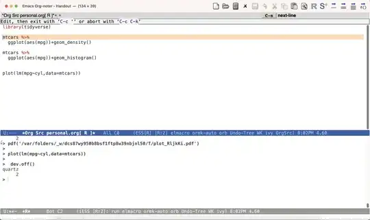

As an alternative, it is possible to write an elisp function to that will save the plot as a pdf and open in on a buffer next to the R process. See for example:
plot buffer
code:
(defvar rutils-show_plot_next_to_r_process t)
(defun add-pdf-to-rcode(rcomm fname) "add pdf(tmpfile) and dev.off() to R command" (let* ( (newc (concat "pdf('" fname "')\n" rcomm "\n dev.off()")) ) (eval newc) ) )
(defun rutils-plot-region-or-paragraph() "execute region or paragraph and save tmp plot to pdf. Then open windows to show pdf" (interactive) (let* ( (fname (concat (make-temp-file "plot_") ".pdf")) ) (progn (if (use-region-p) (ess-eval-linewise (add-pdf-to-rcode (buffer-substring (region-beginning) (region-end)) fname)) (progn (ess-eval-linewise (add-pdf-to-rcode (thing-at-point 'paragraph) fname))) ) (ess-switch-to-end-of-ESS) ) (if (window-in-direction 'right) (progn (select-window (window-in-direction 'right)) (find-file fname) ) (progn (split-window-right) (select-window (window-in-direction 'right)) (find-file fname) ) ) ) ) ) (define-key ess-mode-map (kbd "C-c g") 'rutils-plot-region-or-paragraph)
ref: https://www.fredgruber.org/post/plot_buffer/
