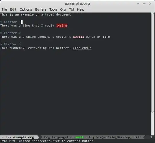

I personally stick to writing things in org-mode with flyspell-mode and langtool...
org-mode is fantastic for typing any sort of document quickly in Emacs, flyspell takes care of spelling, and langtool worries about the grammar. Everything is highly customizable too, so you can customize anything to your heart's content.

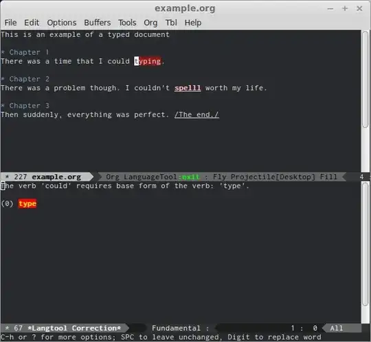

Here is a quick little type-up in org-mode with langtool and flyspell enabled; nothing too special.
If I run langtool-correct-buffer like it suggests, any grammar errors langtool found are highlighted one by one with a number of suggestions in the bottom buffer. I can select any of these candidates with the corresponding number key, or just skip over them with the [Space bar].

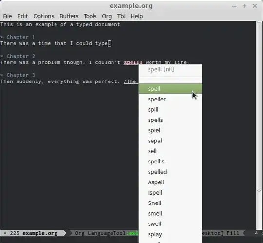

In addition flyspell lets me [Middle Click] on misspelled words to see spelling suggestions.

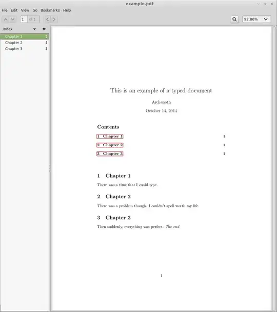

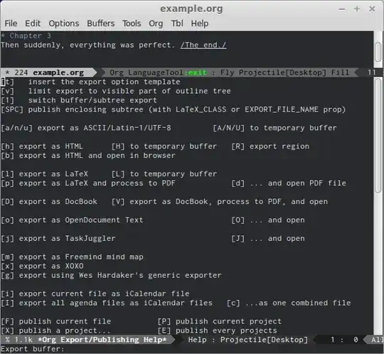

org-mode has a ton of export formats; you can export your document as a PDF, ODT, or even as HTML. (You can export using C-c C-e in org-mode)
Now that I've published my masterpiece as a PDF using LaTeX, this is what I see when I open it in a PDF viewer...
It is probably the easiest way to make fancy-looking documents within a relatively good writing environment in Emacs...
