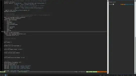

However, i don't know how i can have absolute line numbers on the current and relative line numbers on all other lines (both on the left margin like displayed in the picture below).
this picture of my vim This picute of my vim shows what i want. Therefore, i don't search for line numbers in the mode line.
