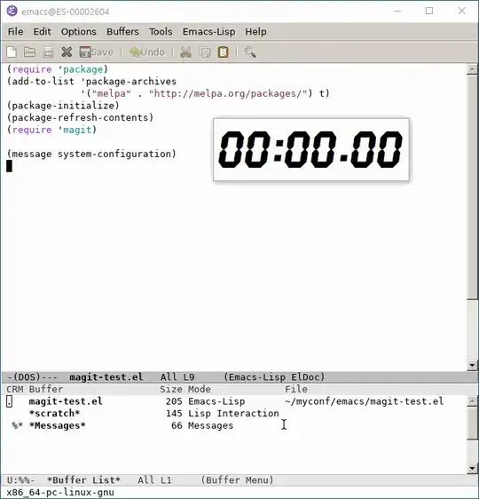

Use Emacs on WSL.
I did an extensive use of magit when I worked on a Linux box.
But was kind of forced to use Windows 10.
I tried to use Magit though I couldn't stand how slow it was.
So I just switched to SublimeMerge for git use.
After one year using it, I haven't looked back.
But since I have tried native Emacs on Windows and Emacs on WSL...
Just made a test to check magit-status on same repo.
I manually started a stopwatch with a hotkey in Windows.
So there is a bit of time gap between when magit-status ends and when the watch stops.
In my case Emacs-on-WSL beats Emacs-on-Windows by ~2 secs vs ~6 secs.
Both tests made starting emacs with emacs -Q.
