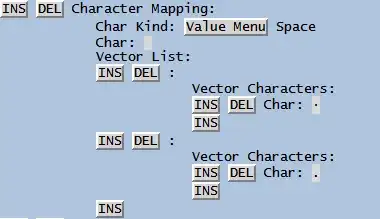

Customize option whitespace-display-mappings, to get rid of this entry:
(space-mark   ?\     [?\u00B7]     [?.])        ; space - centered dot
That maps a SPC char to a centered dot.
M-x customize-option RET whitespace-display-mappings RET
This is the entry to remove or change, in the Customize UI:
You can just click the first DEL to remove it, if you do not want SPC chars mapped to other chars. (Save your changes when done.)
