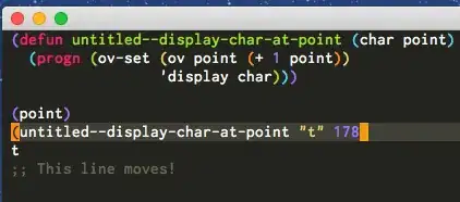

I am using the ov library to display overlays.
If I try to insert an overlay into an empty line, it truncates the line. See the pictures below to understand the problem, and use the code to reproduce it.
(ov.el is just a wrapper using emacs' overlays, so this should not be a library specific problem.)

The below is another example of the same happening. If you evaluate this:
(defun untitled--display-char-at-point (char point)
  (progn (ov-set (ov point (+ 1 point))
                 'display char)))
(point)
(untitled--display-char-at-point "t" 184)
;; hi
;; This line moves!
you end up with this:
                 'display char)))
(point)
;; hi
t;; This line moves!
GNU Emacs 24.5.1 (x86_64-apple-darwin14.3.0, Carbon Version 157 AppKit 1347.57)

The question has nothing to do with spacemacs, so the reference to that library/configuration should be removed from the question so as not to confuse other forum participants.
The original poster should use a test to determine whether point -- where the overlay will be placed -- is at the end of the line, and use either of the following if that is the case:
  • The 'display property with the string plus a new-line \n -- e.g., "t\n"
  • The 'after-string property with just the string -- e.g., "t"
A sample test is as follows: (= (point) (point-at-eol))
When point is not at the end of the line, just the string and the 'display property will suffice.
Here are two examples of overlay placement when point is at the end of the line:
(overlay-put (make-overlay (point) (1+ (point)) 'display "t\n")
(overlay-put (make-overlay (point) (point)) 'after-string "t")
